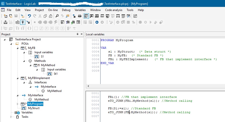

    Hi George I’ve tried to recreate the same behaviour you report in the TestInterface program (Download).
    In the screenshot you can see the program structure.
    Can you verify if the program I made recreate exactly your situation?
    #81777
    George
    Yes I tested your program and compiles correctly.
    Now I gonna test this function in my program.
