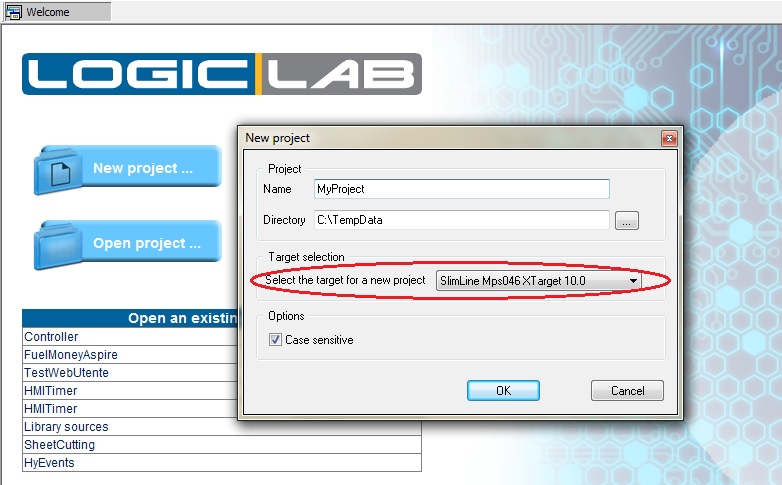

    When you install the LogicLab program (It must be downloaded from our web site) the install program install also all the available libraries and also some examples programs. In the program install directory there are the Libraries and Examples directories on which all the libraries and examples are (View screenshot).
    If you create a new project by defining as target the SlimLine module (View screenshot) when the workspace will be open, by clicking on the Library icon (Or using Ctrl+L keys) you will see all the target variables and blocks (See screenshot).
