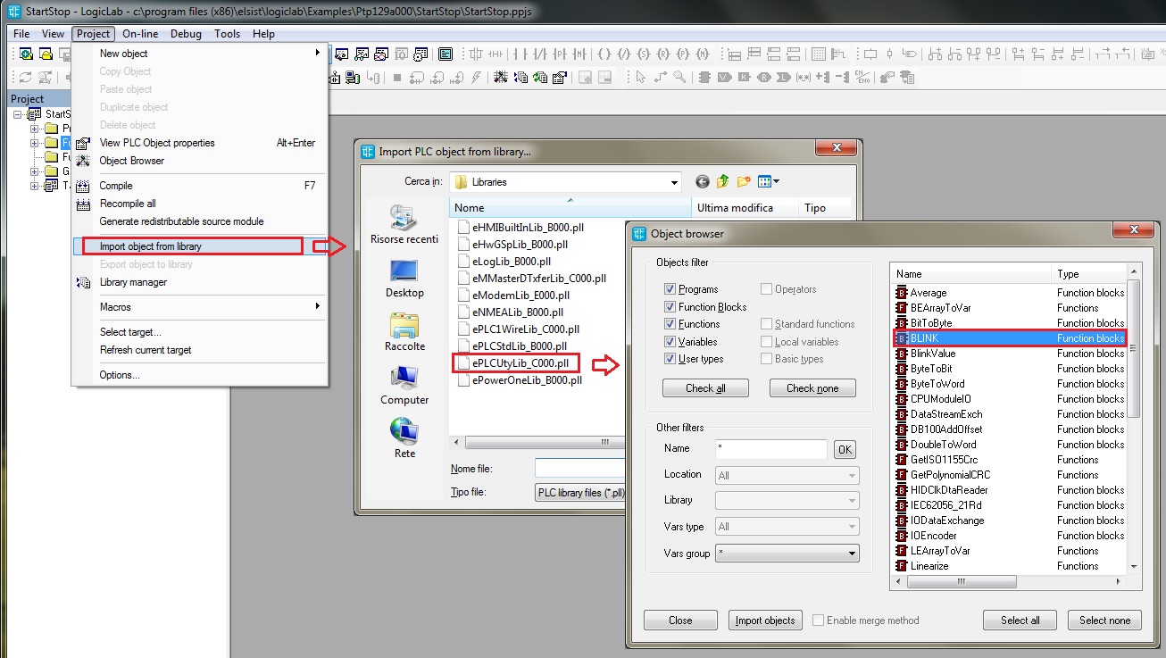

    Another suggestion, to reduce the source code and so the required time to download it on the target (If you choose to download it) is to include in your project only the library objects you use in your program and not all the library. So for example if you use the BLINK FB from the ePLCUtyLib you can import only it from the library insted of attach all the library to the project (See screenshot).
