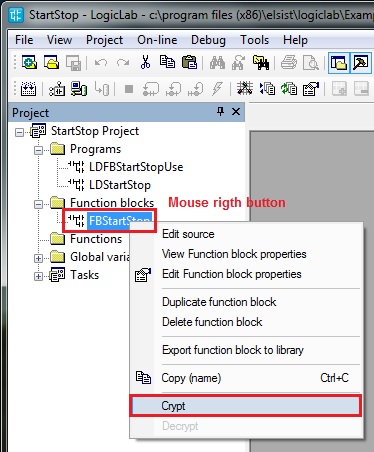

    Your FBs can be protected by checking the MID by code on them, and obviously the source code of these FBs must be encrypted (Like ours) otherwise anyone can modify the code to bypass the MID control. To encrypt an object, choose from the Logic Lab the object, with the mouse right button menu, select encrypt (See screenshot), and then set a password (a unique password for all the objects or separate password for any object).

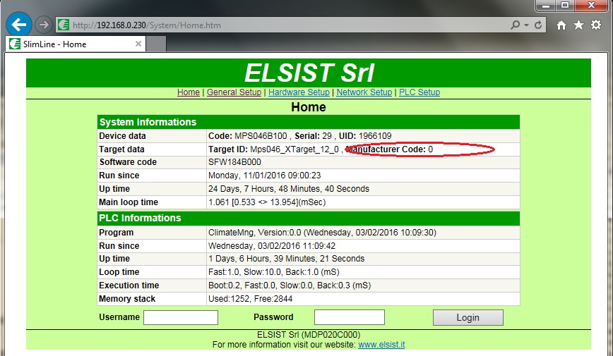

    Yes the customer can buy the MID directly, we will register the code to him and only the products we sell to him can have its MID programmed on. The MID code is not secret, it can be directly seen on the web page (See screenshot), secret (Crypt) is the part of code that checks it.
