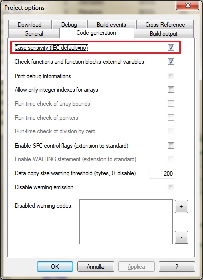

    The SYSTIMER is reported in capital letters because you have not selected the Case sensivity (As we suggest) in the Project -> Option menu (Screenshot).
